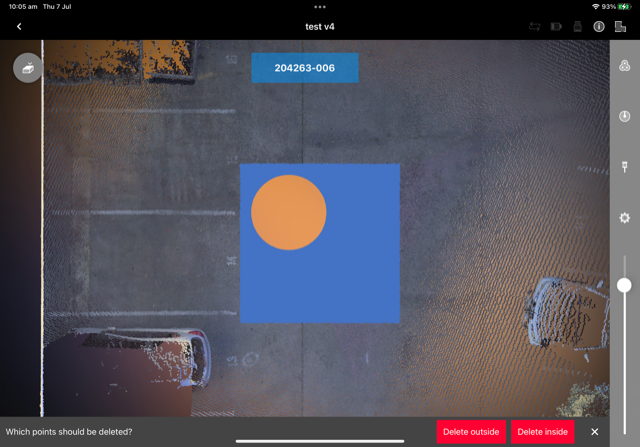

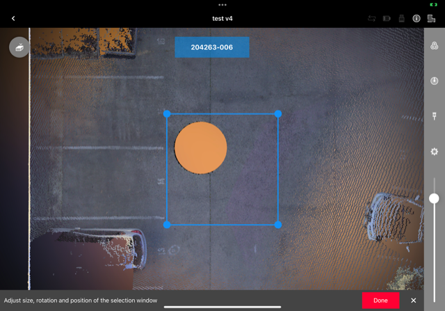

Where do you go in the app to start an Apple Lidar scan? It seems you can only do it in a separate job file without existing BLK/RTC scans?
Does deleting points from the new 3D view delete them entirely?

I haven't verified it deleting points in field 360 affects the import, but I'll have that answer tomorrow. As for attaching the lidar scan to the stationary scans, first select the individual setup, and add a geotag. You'll have the option to 3d scan. I haven't done much testing with that yet, but once you start it, the iPad tries to find it's location based off the lidar/scan overlay and once it "knows" it's location, you just start scanning and save it as you would any geotag. After importing. The lidar data will populate in the dataset and you can run it through a visual alignment to make sure it's as accurate as possible. I'll do more testing with all this tomorrow.tkm wrote: ↑Thu Jul 07, 2022 2:09 am Might be obsolete now, but restarting the Field360 app once the scanner shows as connected in iOS WiFi settings tends to work well for me.
